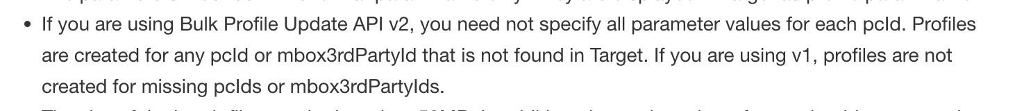

Bulk profile update API documentation says that it "updates existing Target profiles only". However, I tried to use it for non-existing profiles on a Sandbox account and it worked: I can retrieve attributes via the API and Target rules use them when the user logs in for the first time. (I used a thirdPartyId as an identifier.)
Can I count on that behavior on production accounts? I would love to use that feature in a real application.

Yes, this is supported, see the Batch File section of this doc

Thank you @alexbishop
If that is correct, it would be good to update this clause in the documentation https://experienceleague.adobe.com/docs/target-dev/developer/implementation/methods/bulk-profile-update-api.html:
The Bulk Profile Update API updates existing Target profiles only.

Thanks for pointing that out, I've submitted a request for that doc to be updated so that it aligns with the doc that I shared with you
