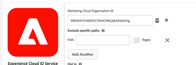

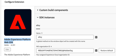

Regarding the same ECID, I have set in both extensions (Experience Cloud ID Service and Adobe Experience Platform Web SDK)
Please take a look:
is any other place where ECID suppose to be added?

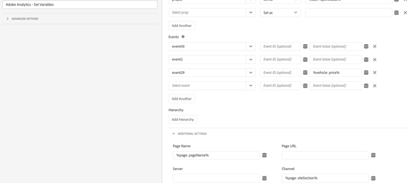

PageName and Events are set up in the same way in client side and server side. Will they duplicate?
Thanks in advance for the response!
