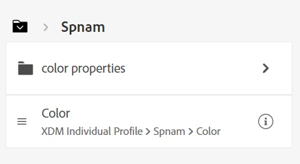

In addition, I think that the setup beetween the two schema should be performed well, since I see on Audience Builder canvas the link of ColorProperties.

Hi @federicov798870  - What you did is correct, in the segment builder canvas you can see the color properties and you can surely create a segment out of it using the properties from color table as well.
However, you can't fetch the attribute from color table via the API due to the limitations of the tool. What exactly you want to do with this? Whats the usecase behind this.
