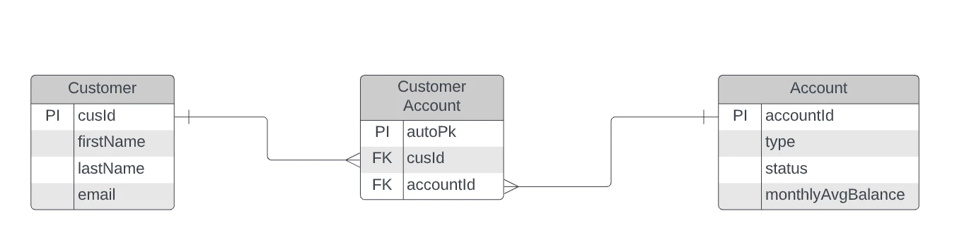

@bitunsen-2022 its a bit hard to grok the issue without a diagram but I'll do my best to answer this.
In the relational world what you are describing a 1:N relationship to another entity object called account. It would typically be modeled like you see below.  With Experience Platform we only support a single entity defined as Person which is composed of fragments of either traits of that person (XDM Individual Profile) or behaviors of that person (XDM Experience Event). In the relational world to bridge the gap between two different entities you would build a bridge table as you see below with Customer Account.

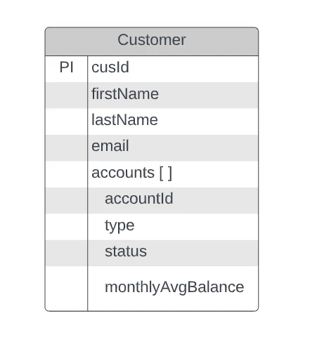

When you go to model this in Experience Platform you cannot think relationally anymore as our system is built on NoSQL. This means that other entities have to be denormalized back into one of the fragment types (XDM Individual Profile or XDM Experience Event).  Below is what we would be expected to be modeled:
You have to denormalize the bridge table and the entity into an array on the profile if you want to know the current accounts each person owns. This does mean you have to think through the data engineering side of this.
