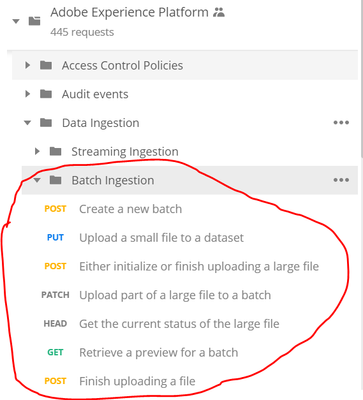

Hello Experts,
Can one help me on how to inject data form json format file to AEP.
Kindly provide process steps or supporting documents.
Best answer by AmitRaghuwanshi
Hi @saurabh_g ,
Here are a few links that might help use AEP APIs.
  1. AEP Authentication Help Documentation
  2. AEP Postman Collections
  3. Adobe Developer Console
Before you test the data ingestion, you should use the postman collection as mentioned in point 2 (there will be a explicit node for Data Ingestion with all required API endpoints. I have also added a screenshot for your reference) and also create the developer console API project as per point 3 and extract the credentials (API key, client secret, and JWT token which are required to call API).
Once you have configured the collection and JWT token, you can follow the following steps,
Hope this helps.
With Regards,
Amit

AmitRaghuwanshi
AmitRaghuwanshiAccepted solution
November 22, 2022
Hi @saurabh_g ,
Hope this helps.
With Regards,
Amit

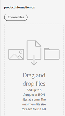

Manoj_Kumar
November 23, 2022
Hello @saurabh_g
One way to do this is via the API as other have suggested. But if you are looking at a one-time import then open the dataset. You can just drag and drop your JSON file to upload data to your dataset.
