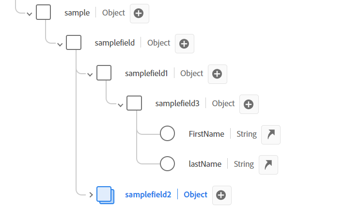

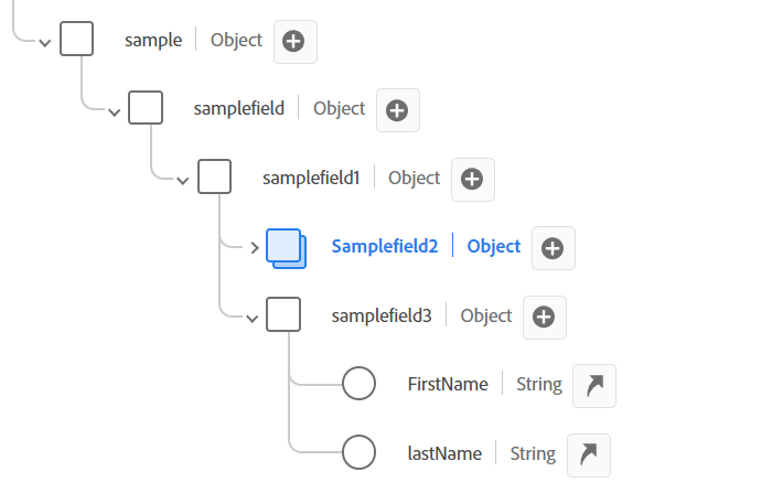

You need to decide on the hierarchy first as per the screenshot samplefield 1 and samplefield 3 are not at same level now, what i mean by this is samplefield 1 is nested in samplefield and samplefield 3 is nested in samplefield 1.
If you want to add samplefield 2 on the same level as samplefield 1 then click on the + icon in front of samplefield and add a field but if you want to add it at the same level as samplefield 3 then click on + icon in front of samplefield1.
If you add samplefield 2 at the same level as samplefield 3 then will be something like this.
however if you add it at the same level as samplefield1 then it would be something like this.

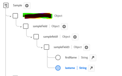

Thank you for responding so quickly. Our criteria are shown in the screenshot below. According to this structure, we must add the samplefield2 object between samplefield 1 and samplefield 3. How can we do that ?
