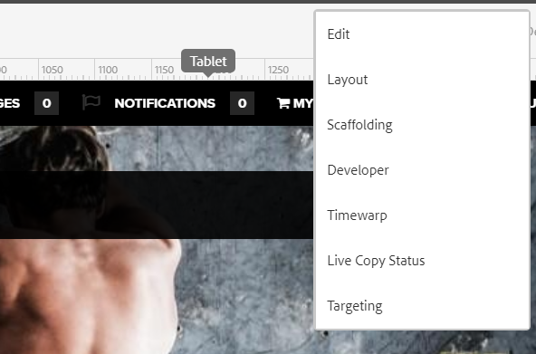

I created a template using We.Retail's base template, and then created pages using that template. I found there is no design mode in the sidekick when editing pages.
When editing the pages within We.Retail, I cannot see Design mode either. See below. My question is why and when Design mode appears in some pages, but not in other pages? same as Timewarp, Timewarp appears in some pages, but not in others.

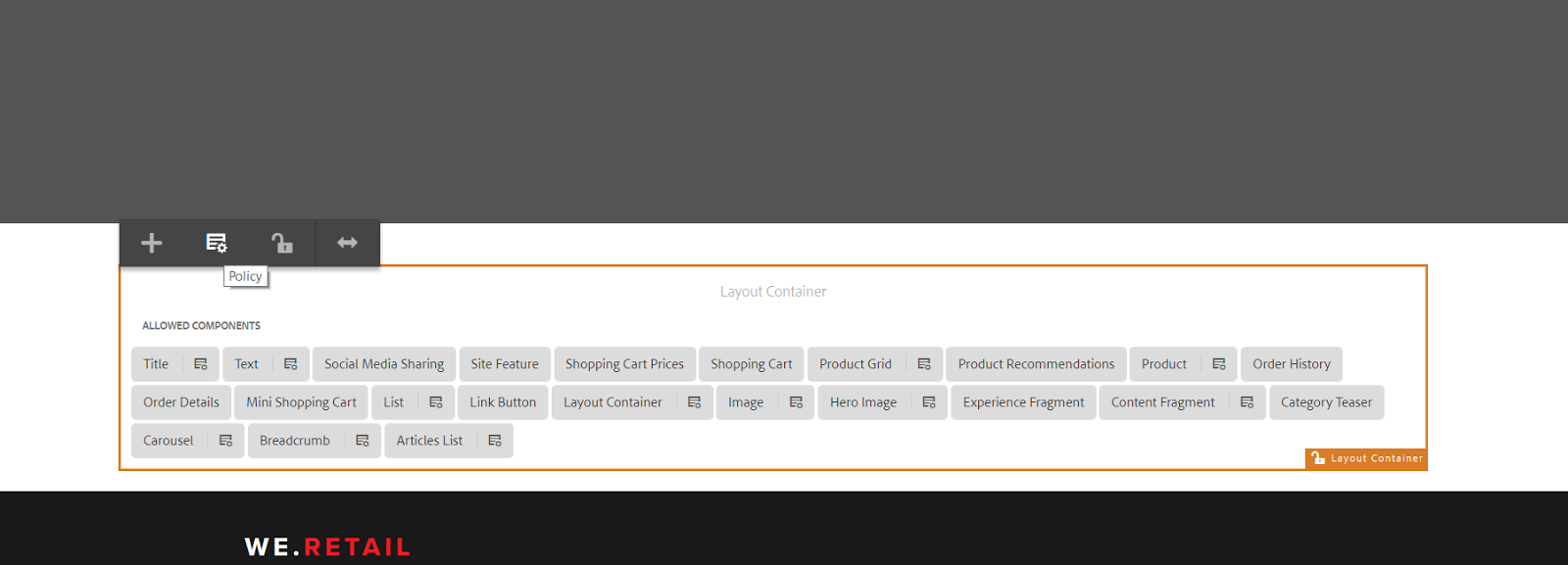

For editable template we can add components by going to the template editor mode
From page properties, click on "Edit Template" option
Which takes to below page and we can add the required components in layout container (Click on second option)
http://<host>:<port>/editor.html/conf/we-retail/settings/wcm/templates/hero-page/structure.html

The design appears in the side panel if the user is using static templates. For editable templates this should not appear.
Veena is correct (that is why we marked her answer as correct)
If you attempt to use Design Mode for We Retail in order to add new components (or other sides based on Editbale Templates), you will notice that Design mode is not there.
The reason is pages based on Editable Templates do not have Design Mode. To add a component group, you need to add the component group by using the editable templates Policy.

Pages created from editable templates do not offer a Design mode in the page editor.
You can do same with Edit mode as well.
