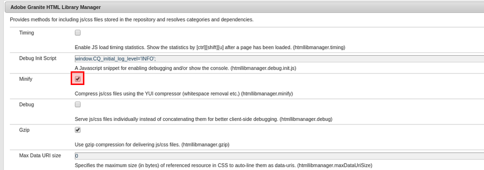

Hi @kotisyamala1,
As you mentioned in a comment to @veenavikraman, if you update a configuration it is not automatically appearing in your application config.
This is because by default, configurations are saved under /apps/system/config.
Here is an example. My config on a (relatively) fresh AEM 6.5 instance:
And now I if I modify the com.adobe.granite.ui.clientlibs.impl.HtmlLibraryManagerImpl config as so (enabling code minification):
Now my configs under /apps/system/config are updated:
It's up to you at this point to add the file to your project (under /apps/yoursite/config) and deploy it to AEM.
Hope this helps 🙂
