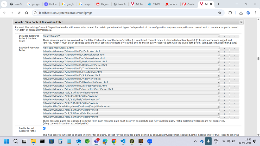

video is getting downloaded i want to play it in browser
when i enter this URL http://localhost:4502/content/dam/file_example_MP4_1280_10MG.mp4 the video is getting downloaded in author i have configured ContentDispositionFilter as but i am getting same issue can you help me with thisScreenshot (61).png

If you look at the description of the below filter, it says the filter adds Content-Disposition as attachment. But to play or display anything directly on the tab, you need the disposition to be inline. So, just add the path you need to the exclude list. This will make the file/video/asset open in the browser tab instead of downloading.

yes its working i have added video/mp4 in exclude list and disabled for all resource path
