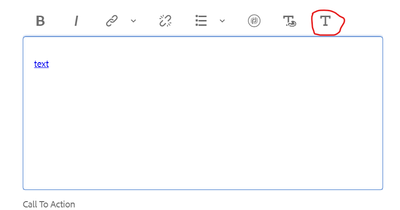

We have a plugin in the Richtext Editor of few components. When we select a word in the Richtext field and click on this plugin, it opens up as a mini dialog, which has 5 fields and 2 buttons to submit.
There is a textfield , in which we provide the URL, now the issue is :
If we provide any URL which has a tag value (for example : www.xyz,com/perk#Anchor) , and save the dialog, and again if I reopen the dialog, the URL value is not saved in the field.
Fig 1. Richtext field with the Plugin (circled in Red)
Fig 2. The URL text field which is having issue (highlighted in red)
This issue is only occurring if I give any #tag value in the URL.

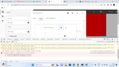

Update 1: After few debugging, I can see few console errors (screenshot attached below)
@kautuk_sahni  @arunpatidar

Do you see any console log on browser while you do the save of dialog
adi411Author
July 17, 2023
Hi @dprakashraj
I see the below console errors
DPrakashRaj
July 17, 2023
To fix handlebars error can you do below to check if it gets resolved?
https://experienceleaguecommunities.adobe.com/t5/adobe-experience-manager/quot-handlebars-compile-is-not-a-function-quot-reported-after/td-p/385609
https://experienceleaguecommunities.adobe.com/t5/adobe-experience-manager/uncaught-typeerror-handlebars-compile-is-not-a-function-aem-6-5/m-p/308256
can you also check what values are being saved in crx/de with url having #. It’s pretty common to use # in the url and it should save the same in crx/de
