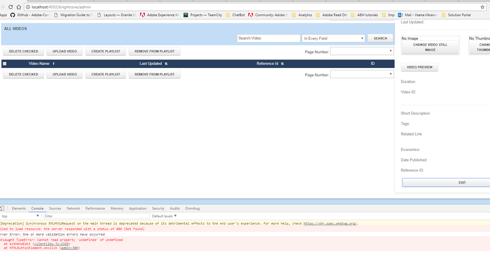

In our current project , We have 3.0.2 version of bright-cove. Since we have migrated to AEM 6.2 , we are planning to upgrade bright-cove to 4.2.0 version. I did test this in my local where my project is setup completely. But even though everything looks fine in the logs and system console, I have issues with upgraded brightcove .
When I edit components which use brightcove , it throws below error in console.

This error means that AEM cannot find the custom xtype. Double check the client libs folder to make sure that you have referenced it properly. If does not work remove all folders under /var/clientlibs/* and running the test again.

After my initial research I could figure out that the version we are currently using is pretty old one and for the current version , the implementation is different from that of 3.x versions. We may have to rewrite the component implementation as per the below documentation from brightcove. http://files.brightcove.com/bc-adobe-experience-manager.pdf . We will try this out in our local and if we still face issues we will get in touch with the support team for the product

So we have atlast solved this issue.
The version 3.0,2 is pretty outdated and setting up the component with http://files.brightcove.com/bc-adobe-experience-manager.pdf this guide is the first steps to follow.
The major change was the xtype 'BrightcoveCombo' is deprecated and instead we have to use 'brc_combobox'. More than that there is major change in how the video component is implemented.
Once the latest brightcove package is installed please navigate to /apps/brightcove/components/content/brightcovevideo and check how the dialog is implemented . Either you can use this component as it is or you can follow the way they have implemented the dialog.
For any video list to populate properly , you should have the account list also added as a field
