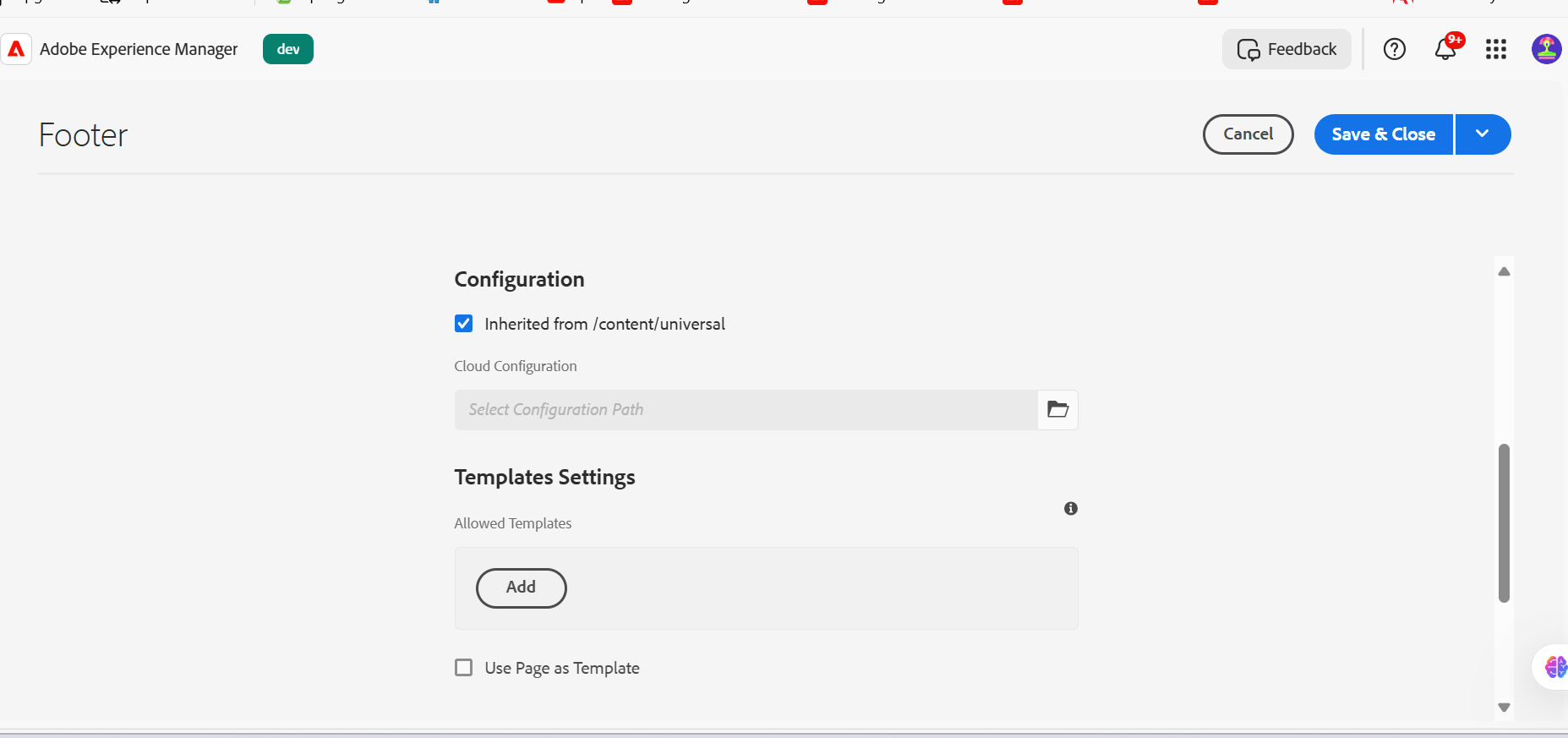

I am trying to setup "universal editor" on AEM as a cloud . Here the page is redirecting to Universal editor but there is not content to edit ,attached the file. I have taken the reference from the below article.

 Thank you for the information. As you said , I have checked the page exits at /content/universal/footer.html , the page is build by using Edge Delivery Services-compatible template , but in page properties there is no option present to enable Universal Editor . I have attached the references below.
