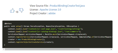

ref: https://programtalk.com/vs4/java/adobe/commerce-cif-connector/bundles/cif-virtual-catalog/src/test/java/com/adobe/cq/commerce/virtual/catalog/data/impl/ProductBindingCreatorTest.java/
