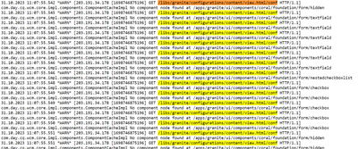

We want to create a project-specific folder like ABC and under this we want to create templates. (suppose /conf/ABC(folder)/XYZ-Template)
While creating folder ABC getting an error "there was an error while creating new configuration"

There seems to be some issue with the /apps/granite .....
Can you please check that customizations have right jcr:primaryType?
Also, try deleting these customizations and then create /conf via Configuration Browser
http://localhost:4502/libs/granite/configurations/content/view.html/conf

@Vani1012
Also, these are warning messages, not error. Can you please check the logs again?
