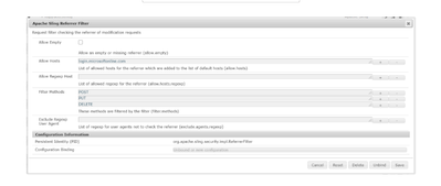

This is my referrer. I have tried wiht Allow Empty unchecked and add POST to filter methods. No luck there either.
Here is the Cross-Origin Resource Sharing policy.
I think I have all this correct.
