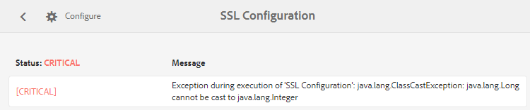

We enabled SSL for Author and Publish using the SSL by Default method for AEM 6.4.  SSL is working as expected.  However in the Operations Dashboard the "SSL Configuration" security check is in status:CRITICAL.  It is producing an error.  I believe the error is caused by a data type mismatch in the code that does the health check rather than the health check finding something critical, but I am not sure.
Error:
Exception during execution of 'SSL Configuration': java.lang.ClassCastException: java.lang.Long cannot be cast to java.lang.Integer

Is this a problem with the health check code?
If not, what do I need to do to get the health check to change to status:OK?
Any other suggestions?
This is occurring on AEM 6.4.3 and AEM 6.4.8.

After working with technical support this is my understanding of the issue...
Turns out this is an issue when configuring OSGi using the content-node method.  When using content-node and creating the configuration as a sling:OsgiConfig node with properties there is no type of Integer.  Typically Long will work in place of integer, but the SSL Configuration Security Check code requires the number to be an Integer for the SSL port property.  As a work around use the Adobe Web Console to set the properties for SSL.
/apps/system/config/com.adobe.granite.jetty.ssl.internal.GraniteSslConnectorFactory
