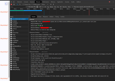

I created a Sling Model with an exporter and I'm trying to get JSON on request from the ReactJS App.
ReactJS app:
I also created a filter for the set headers for CORS:
If I make a request from the browser, I will get JSON but not from ReactApp.

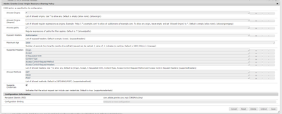

And configuration from AEM:
I use AEM 6.4 version.

Have you tried configuring the "Apache Sling Referrer Filter OSGI configuration"?
Documentation here: https://sourcedcode.com/in-aem-what-is-the-apache-sling-referrer-filter-osgi-configuration

@aliaksandr_hvoz
