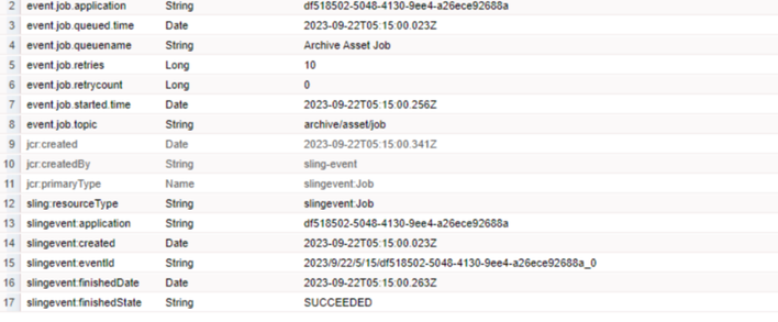

I'm experiencing an issue related to Sling Jobs in AEM as Cloud Service.
  • I have a scheduler set up to trigger an archive Sling job.
  • When the job is triggered, the corresponding job node gets created in /var/eventing. However, almost immediately after its creation, the job node disappears without any traces of execution.
  • There are no exceptions or errors logged in the system.
  • I have observed that the creation and finish dates of the job are almost identical (refer to the attached screenshot for details).
  • The scheduler is configured to run exclusively on the Leader Node, ruling out potential complications from a distributed cluster setup in AEMACS.
