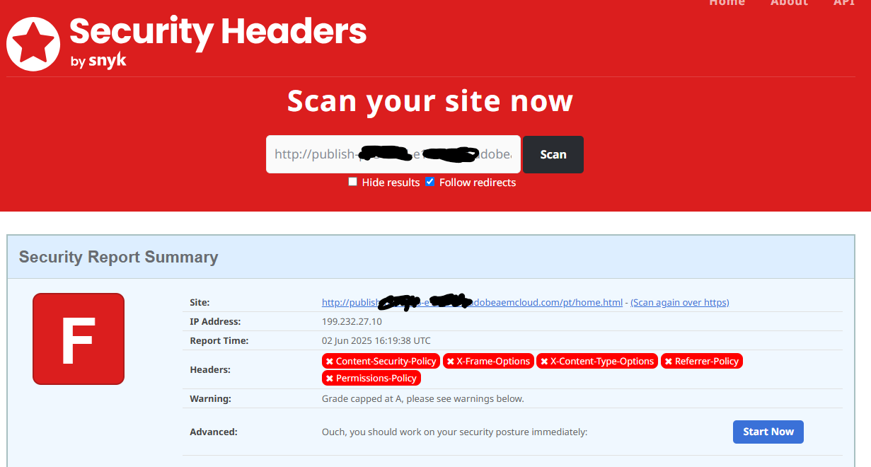

I need to implement Security Headers in the PROD environment, but it is not working, but it works in the developer and stage environments.
I use the website https://securityheaders.com/ to validate if the Headers are working and it returns a grade of F (no headers implemented) in the prod url, but returns a grade of A (excellent implementation) in the dev and stage publish links.
All my backend files in the dev, stage and prod environments are the same, with the same implementations, but the headers only appear in the dev and stage publish, they do not appear in the Prod environment.

How can I check which version of AEM I am using? Unfortunately, I don't know which version I am using.
The site has a URL that starts with both http and https, and both in dev and stage the security headers are displayed in the dev tools header, but the prod one does not return the headers.
All the headers are missing in the PROD URL.
The security headers are configured correctly in the dispatcher settings.

Looking into the screenshot you shared you are using AEM as a Cloud Service.

Looking at the link https://publish-<env>.adobeaemcloud.com in DevTools, the titles are all ok in the PROD environment. However, when looking at the link to the website that the general public accesses (http://example.com), it does not return any headers.
