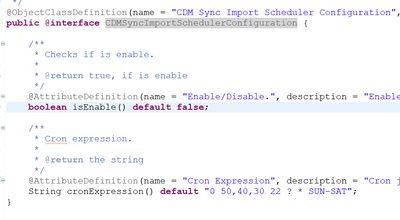

We have created Scheduler called CDMImportScheduler in AEM6.5.CDMImportScheduler is not getting triggered now. We are seeing in CDMImportScheduler is running very long in "Scheduler Health Check ".
After doing soft restart from webconsole i am not seeing CDMImportScheduler in Health checks. Health check is normal but scheduler is not still running. How to handle and resolve this issue.

Pls find the code snippet above. It requires soft or hard restart every day to execute the scheduler

After executing scheduler for 30 to 40 times a day, scheduler stops to execute and requires soft or hard restart.
