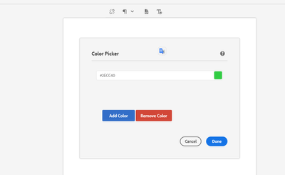

Hi Team ,
Above image is color picker implementation from my component which is working fine .
But I am facing issue when I click on  the cancel and done button in the above dialog .

Hi @mamathary999 , @arunpatidar , I am also facing same issue when I click on cancel button and blank dialog when I click on done button in AEMaaCS, can you please help me with what is causing this error.
This is because of error in javascript. Can you check the console error?
