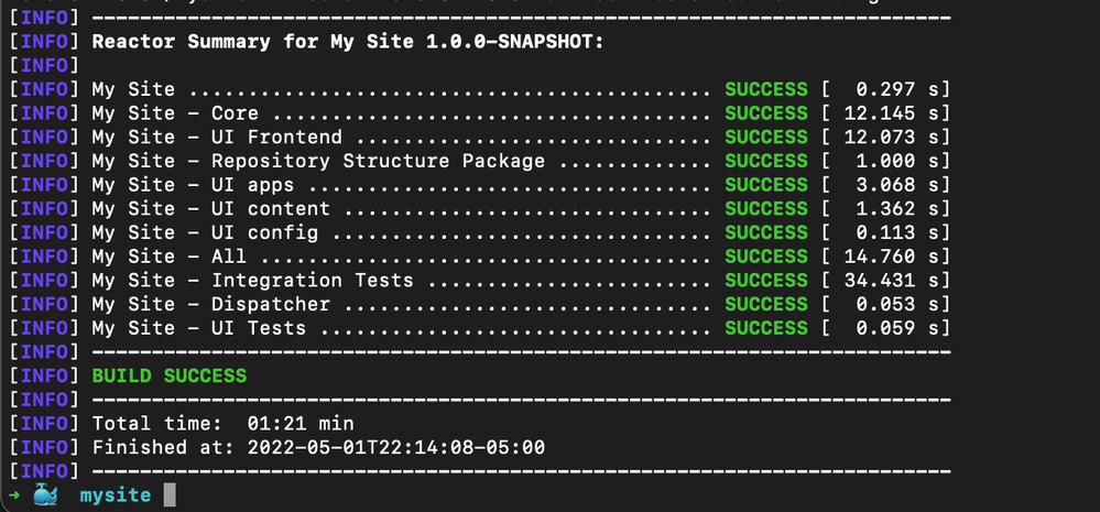

When I built wknd site from github using maven, I was able to successfully build it and obtain all the artifacts. However, in the AEM UI when I click on Navigation->Sites, it gives the errors attached in the screenshots.
P.S. I haven't made any changes to any default config files.
Screen Shot 2022-05-01 at 10.40.52 PM.pngScreen Shot 2022-05-01 at 10.41.31 PM.png
