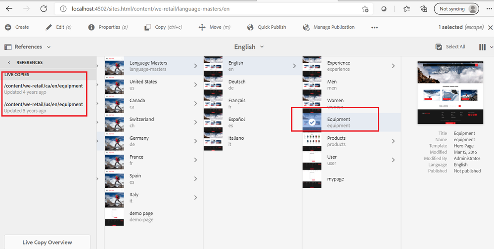

You can check the live copies in reference tab. Just select the page and open the left rail to see the references.
