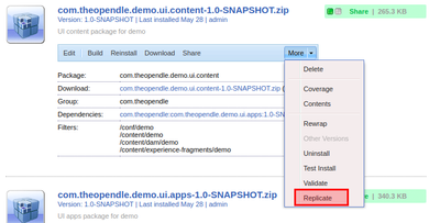

1. Once you've configured your replication agent to replicate to Publisher, you can replicate packages through CRX DE with the following option:
