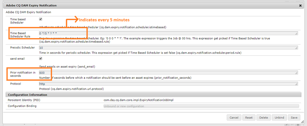

We faced the similar issue like yours when we set "Time Based Scheduler Rule" time as 5 minutes and "Prior notification in seconds" time as 2 minutes. However, we were able to resolve this issue by setting Time Based Scheduler Rule and Prior notification in seconds as shown in the below screenshot.
From the above screenshot, you can see that -
1) "Time Based Scheduler Rule" is set as 0 */5 * ? * *
This indicates that scheduler is scheduled to run every 5 minutes.
2) "Prior notification in seconds" is set as 600 seconds (i.e. 10 minutes)

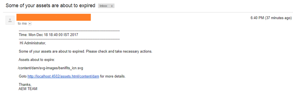

That is, "Time Based Scheduler Rule" time is less than "Prior notification in seconds" time (5<10). In this case we could see "Some of your assets are about to expired" email as shown in the below screenshot.
So possible reason behind your issue is, your scheduler is getting executed after the assets get expired. Hence please check your Time Based Scheduler Rule and make changes to it accordingly.

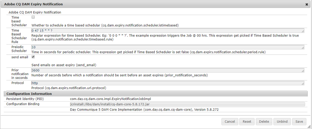

Hello TechAspect Solutions
Thanks for your explanation and hints.
Finally I just work this out, the "expires time" should be initiated greater than or equal with "Time Based Scheduler Rule" +"Prior notification in seconds", if the "expires time" is between the start of "time based schedule" and "Prior notification in seconds", the notification will not be triggered.
