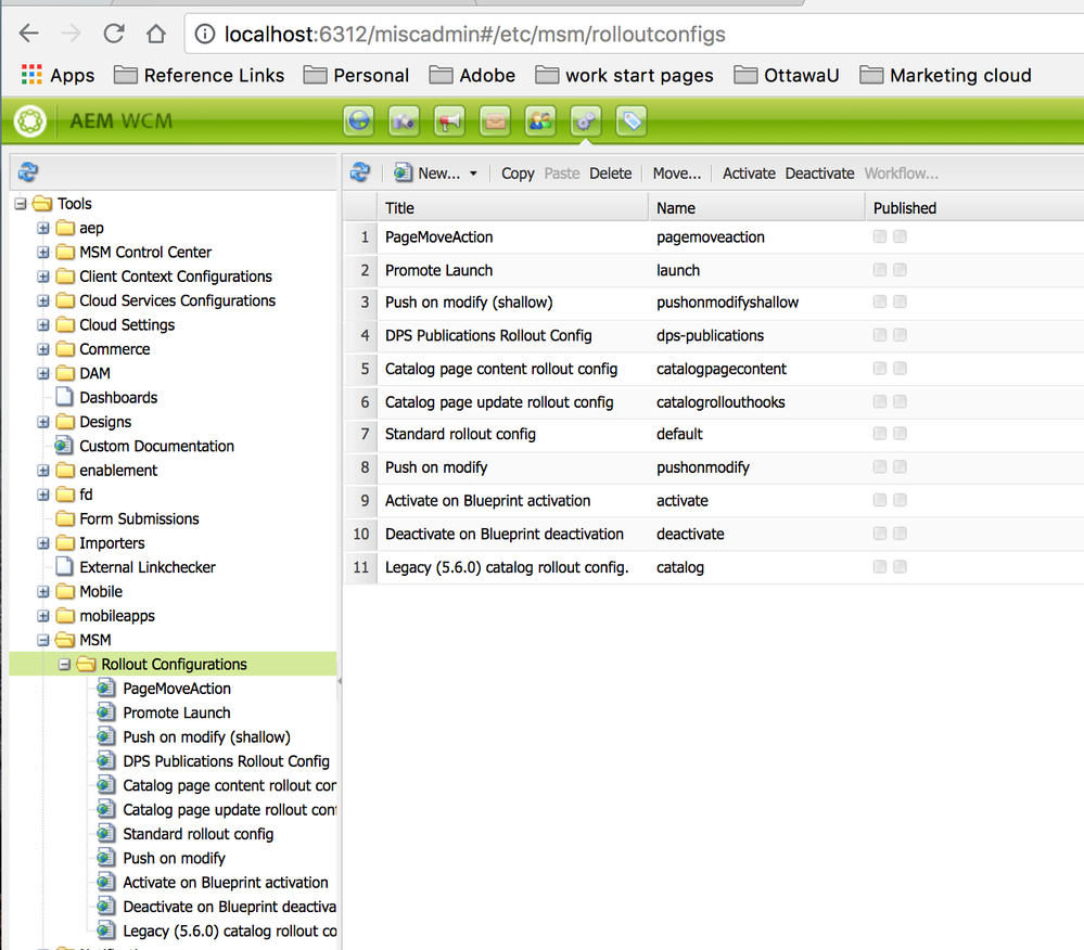

Hello suprajas43649601
Could you try to move the pageMoveAction rollout to the top of the list for the rollout configs in the crx/de as well and see if that helps? The final results should look like this
I don't see any information about the version of your AEM but this is working for me in AEM 6.3. If it still didn't help, please share some more details about your setup and configuration.
