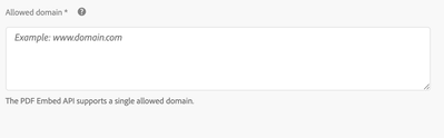

Hi @SDusane ,
As per the help text provided while adding allowed domain in Developer Console, the PDF Embed API only supports a single allowed domain. Comma-separated values and Wildcards are not supported for this API.
It is recommended that you create a separate credential for each sub-domain.
Although I have not tried this myself, you can see if adding the root domain works for sub-domains. i.e. Add example.com in allowed domain to allow www.example.com, stg.example.com, dev.example.com and more such subdomains.

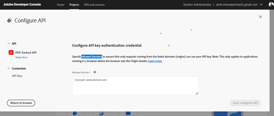

Hi @AmitVishwakarma ,
I am using AEM Cloud and my comments are below :
1. Being Sys Administrator on Developer Console, I dont see the option to edit the allowed Domains sections, so not a solution for me.
2. I created new credentials from link https://acrobatservices.adobe.com/dc-integration-creation-app-cdn/main.html? and tried to put all the domains in text box but it is not allowing me to add more than 1 domain.
3. I created new project directly in Developer Console and tried to put multiple domains, that too is not acceptable to put all the domains.
So at the end, nothing is working for me to add more domains with same client ID, can you pls suggest if there is any other way.

Hi @SDusane ,
Ram
