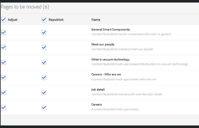

we would like to to change URL of the page without republishing the references so unticked the “republish” box for the pages seen in the screenshot but they got republished regardless.

@Vani1012: If the reference page(s) were previously activated, then ideally they should be re-published as well otherwise you will start to see broken links on them.
Maybe you can create some new test pages which refer your <page-to-be-moved>. Ensure you have not published those test pages. Then try to un-check the 'Republish' box while moving the same page and see if it still re-publishes the reference pages.
For page move, documentation says:
If the page was already published, moving the page will automatically unpublish it. By default, it will be republished when the move is complete, but this can changed by unchecking the Republish field in the Adjust/Republish step.
Yes to change I unchecked republish option eventhough it is publishing.
