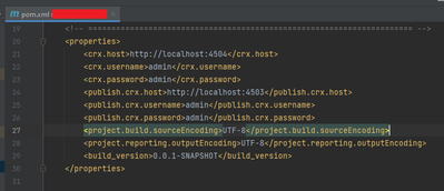

Please check main pom.xml and update port to 4502 and credentials if required
@Imran__Khan The pom.xml files look the same as yours.
My issue is not about the installation of the project on 4502. The build is successful on 4502, but the issue is with the OSGI services configurations that is removed.
I hope you got my issue now
