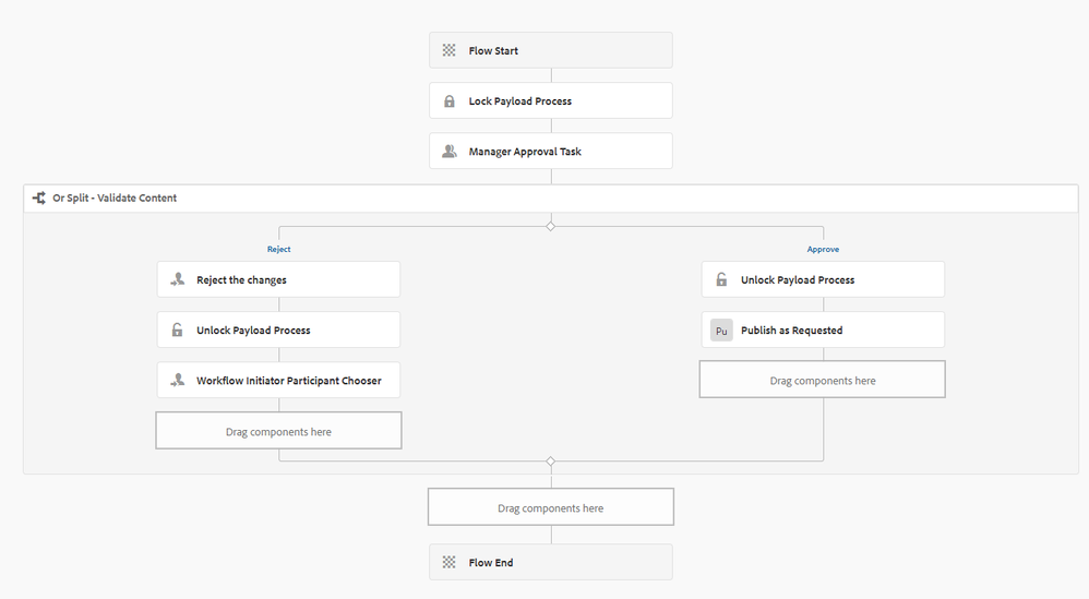

I'm currently  working on an AEM Approval Workflow, and I've hit a bit of a roadblock. I'm struggling to properly set up the initiator, and I could use some assistance.
Here's a breakdown of my workflow:
The Manager Approval task is a custom implementation of ParticipantChooser, where I retrieve the workflow initiator using:
String initiator = workItem.getWorkflow().getInitiator();
Afterward, I identify all the groups this user belongs to and match the author group to the approval groups. This part works smoothly when I manually start the workflow.
However, my goal is to streamline the process for authors by triggering the workflow automatically when the authors publish content using a launcher.
Here lies the issue: when the launcher triggers the workflow, the user is set to "workflow-service" which prevents me from finding the correct approvers.
