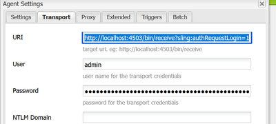

I downloaded the latest AEM SDK aem-sdk-2021.11.6023.20211111T113531Z-211000.zip,  and rename the jar package to to aem-author-p4502.jar and aem-publish-p4503.jar, both the author and publish is able to run successfully. And I enabled the replication  agent.
Then I successfully build the sample code(https://github.com/adobe/aem-guides-wknd) and deploy to local author.
I published the changes in author, but  can't see anything in local publish environment. Any suggestion? Thanks
And when I try to check http://localhost:4503/content/wknd/us/en.html, it's a blank page

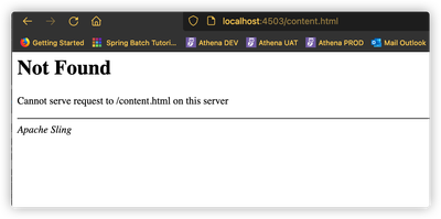

We have to do mapping configs for redirects. Please refer below article to get some idea.
https://www.albinsblog.com/2020/07/configure-sling-mapping-for-resource-resolution-in-adobe-experien...
and JFYI the reason you are redirecting to localhost:4503/content.html if you hit localhot:4503 is due to config of default root mapping of publisher.
Go to
http://localhost:4503/system/console/configMgr
check for "Day CQ Root Mapping" property.
Similarly for author instance if you hit localhost:4502 it will redirect to localhot:4502/aem/start.html

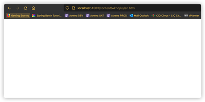

Then I made some changes for en and publish that,
But in local publisher ,it's a blank page
Any suggestion? Thank you!
Hi @wkk52586
Run below command to deploy in publisher instance and then check please.
mvn clean install -PautoInstallPackagePublish

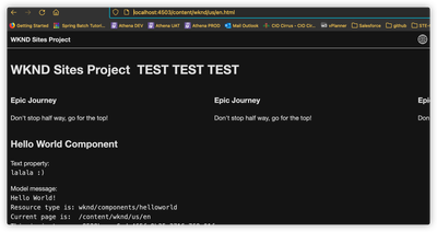

@Kishore_Kumar_Thank you.
Now I can see the content with URL
But I can't see the content directly with URL http://localhost:4503/

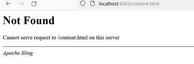

Go to
On the publishers /content is the default page.
You see 404 because /content node is not a type of page but a folder.
you can ignore this and make sure content in your project rendered properly.
