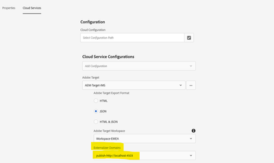

We are using AEM Cloud to build our CMS. Currently, we have exported some experience fragments to Adobe Target as HTML format and many of them have CTA links. Even though we have used the Externalizer domain option like mentioned here -
But this does not help, since the CTA link then forms like this -
What we need is the public url, which works normally when this XF is not exported. I tried using this interface LinkRewriter suggested below, but apparently this doesn't even get invoked from my service-
