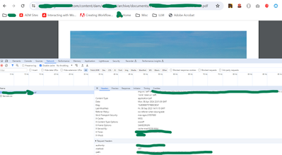

The expected result should be like below image:

Actually I should able to see the Link response header like below in dev environment. Below screenshot represents my local server Response header
However, I could not see any Link header in dev environment's apache server like in my local server. Please look at below screenshot
Yes, I am sure that I am not able to see any cached version of asset .
Thanks 🙂
