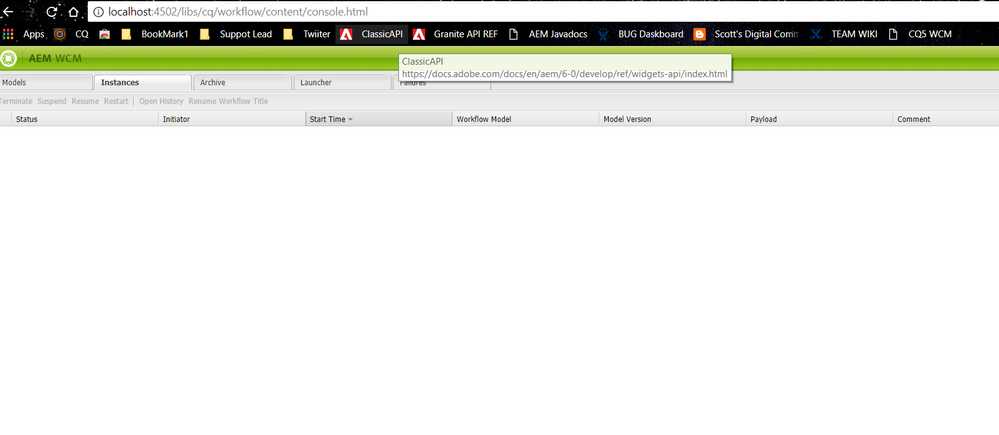

Thanks for the reply. How could we determine the number of workflows which are running at a particular time. Appreciate your help here.
Sindhu.
You can determine the running WF instances here:
Hope this helps...
