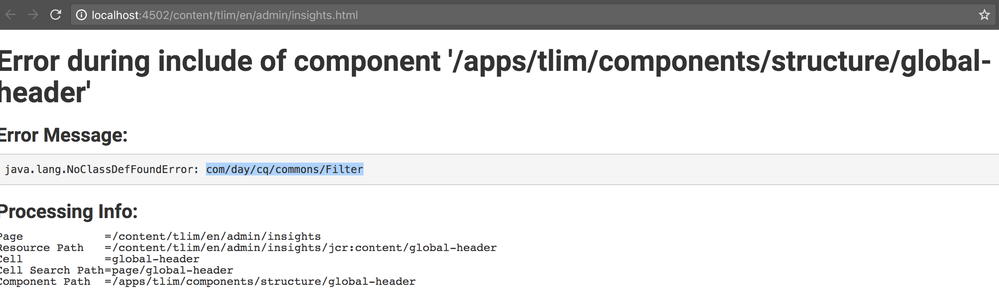

java.lang.NoClassDefFoundError: com/day/cq/commons/Filter ?
I am getting this exception in runtime while my project is built on aem6.1 and deployed in aem6.2 server.I tried using the aem6.2-uber.jar but it results in some other issues.Can anyone help on how to resolve the issue?

Thanks!! but the thing is that I need to run the project developed using AEM6.1 in the AEM6.2 server so what i did is that i changed the uber jar in the parent pom.xml to aem 6.2 so its getting build success without any compile time issues and the my bundles are active in the felix console while loading the component in the page it throws the same java.lang.NoClassDefFoundError: com/day/cq/commons/Filter error.
The following is the changes i made in parent pom to make the project run in aem6.2 (actually it got developed in aem6.1)
<dependency>
                <groupId>com.adobe.aem</groupId>
                <artifactId>uber-jar</artifactId>
                <version>6.2.0</version>
                <classifier>obfuscated-apis</classifier>
                <scope>provided</scope>
            </dependency>
also find the attached screenshot for the error that has been thrownScreen Shot 2017-12-26 at 6.31.38 PM.png

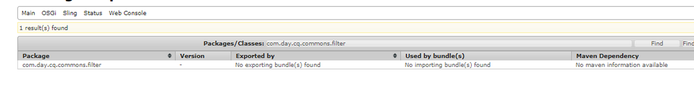

Class no found exception occurs when the bundle is not available in the console. Is this any import referred in a JSP file ? If so , either you might have to convert it to an HTL component or you might have to add this particular bundle to your felix console.
Why you got error at runtime and not during compile time ?
         While you build your bundles, maven will download the dependencies mentioned in the POM.xml to the local maven repo under c:/<users>/.m2/repository and will build your bundles successfully. But when you install the same to your AEM , these dependencies/bundles are expected to be available in the felix console. If in case any of the bundle is not available it will throw you a No Class def found exception
   If the classes are imported in JSP, they will still be built successfully as those are not mentioned in your pom.xml and your maven compile command will not worry about any dependencies not mentioned in the POM.xml and go ahead assuming it is available in the console.
