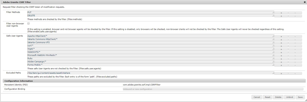

This is my CSRF Filter
I have these rules set

POST method is removed in 'Filter Methods' which is fine for testing but not from security viewpoint.
