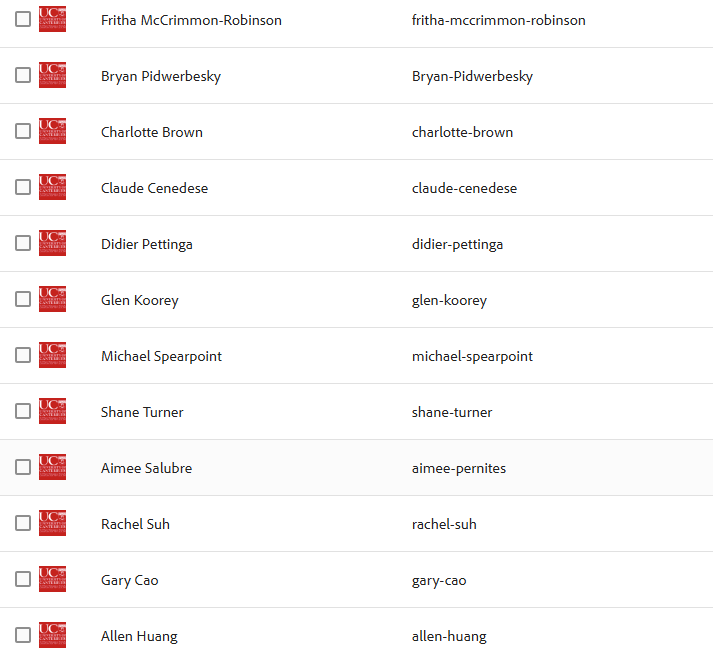

  5. Which still doesn't take me to the actual file, it takes me to the parent folder which I then scroll through 100s (to put my rant in context, this is a staff profile page of which we have over 1000 of) of pages to find it and because there is no sort by options for sites/pages it could be any random order - see attachment Pt 3.

3. AND!!!!...have the ability to sort the columns by date/name/modified/published ascending/descending - like you can in the DAM/Assets (attachment Pt 3)
