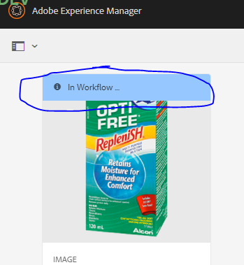

How to programmatically control the status of Uploaded Asset?
We have a custom Workflow where it move the asset from one location of the dam to other. Once after the move even workflow Status is completed. Asset Status would display as "In workflow" not "New"
Added purge event for workflow payload after the completion of the process. Still no go.
Any idea how to get rid of "In workflow" Status?

Hi @mrudul ,
Generally, this shows up when the workflow is still doing some job on the asset. Have a look at the Archives and Failures in workflow console.
This will give you idea that what task is still in progress, and you can achieve them programatically by steps mentioned by Ravi.

Hi @antoniom5495929  @milind_bachani  @Ravi_Pampana ,
Just to add on to this. We dont see any workflow instances running and only the status is showing as in workflow. Do we need to set any property to show it as new?
