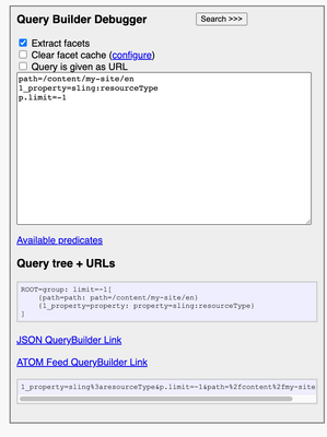

Hello Everyone -I am trying to get all the components that are on the website. I wrote a below query to get the component,
path=/content/my-site/en
1_property=sling:resourceType
p.limit=-1
Note I selected "Extract facets" at the top to get all components.
This query works for subpages so there is no problem in the query.
But this query is not working at home page level  as it needs to traverse a lot of nodes. Hence I increased the LimitReads and LimitInMemory property in the JMX console. Also increased Xmx and MaxPermSize values
CQ_JVM_OPTS='-server -Xmx3072m -XX:MaxPermSize=512M -Djava.awt.headless=true'
But still AEM is not responsive and it keeps loading and responsive after a few mins. In the logs it recommended to have an index created so I am planning to create an index for my above query but the index generator is not working(below URL).
Oak Index Definition Generator in AEM
http://oakutils.appspot.com/generate/index
Could anyone tell me how to write a index for above query ?

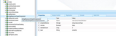

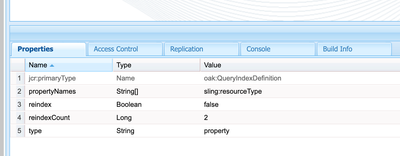

Level 9
Thanks for your response. Even after query index I get below error
25.04.2023 22:11:36.611 *WARN* [0:0:0:0:0:0:0:1 [1682440789217] GET /libs/cq/search/content/querydebug.html HTTP/1.1] org.apache.jackrabbit.oak.plugins.index.Cursors$TraversingCursor Traversed 466000 nodes with filter Filter(query=select [jcr:path], [jcr:score], * from [nt:base] as a where [sling:resourceType] is not null and isdescendantnode(a, '/content/my-website') /* xpath: /jcr:root/content/my-website//*[(@sling:resourceType)] */, path=/content/my-website//*, property=[sling:resourceType=[is not null]]); consider creating an index or changing the query
Log says "consider creating an index" seems it is not considering the query that I placed.
The instance is stopped response after traversed to 466000 nodes. Do we need to pass the /content/my-site in query index? But as per below index, the system indexed properly and increased the index count.
Level 9
Yeah, I have the same index but the node name alone is different but node name can be anything I guess
