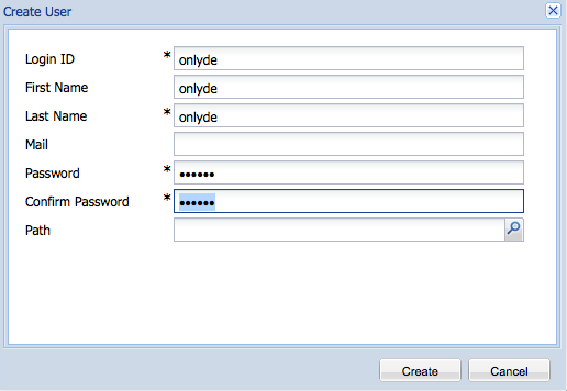

Assume you have one author instance namely author and two publish instances namely publish1 & publish2. The contents activated for site "/content/geometrixx/en" should get replicated only to publish1 and similarly contents activated for site "/content/geometrixx/de" should get replicated only to publish2.
You need to follow three simple steps mentioned below for each site.
Environment:- There are three local instances running
Configure Instance:- First configure for site "/content/geometrixx/en" by following steps mentioned at "Solution" section.
Similarly configure for site "/content/geometrixx/de" by following steps mentioned at "Solution" section. Snapshots below

org.apache.sling.api.scripting.ScriptEvaluationException: javax.servlet.ServletException: com.day.cq.replication.AccessDeniedException: Replicaiton Agent [test-replication-agent]- Agent user [dummyuser] doesn't have sufficient permission on [/content]
| Page | = | /etc/replication/agents.author/test-replication-agent | |
| Resource Path | = | /etc/replication/agents.author/test-replication-agent/jcr:content | |
| Cell | = | agent | |
| Cell Search Path | = | agent | |
| Component Path | = | /libs/cq/replication/components/agent |
the above error is thrown when replication agent "Test connection" is done.
the attached screen shot shows the permission granted to user for a particular page. I tried to allow with read permission only...but that was not working. So i granted all permission to the website.
Pl guide if something is found regarding this
