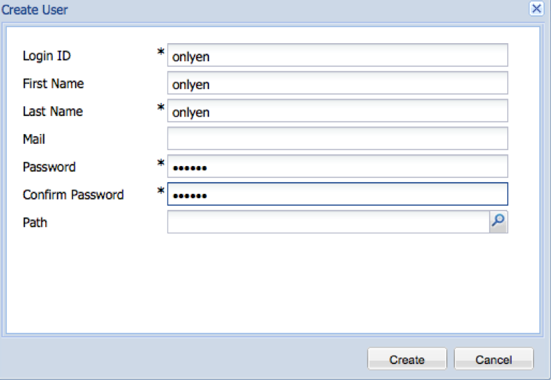

Assume you have one author instance namely author and two publish instances namely publish1 & publish2. The contents activated for site "/content/geometrixx/en" should get replicated only to publish1 and similarly contents activated for site "/content/geometrixx/de" should get replicated only to publish2.
You need to follow three simple steps mentioned below for each site.
Environment:- There are three local instances running
Configure Instance:- First configure for site "/content/geometrixx/en" by following steps mentioned at "Solution" section.
Similarly configure for site "/content/geometrixx/de" by following steps mentioned at "Solution" section. Snapshots below
