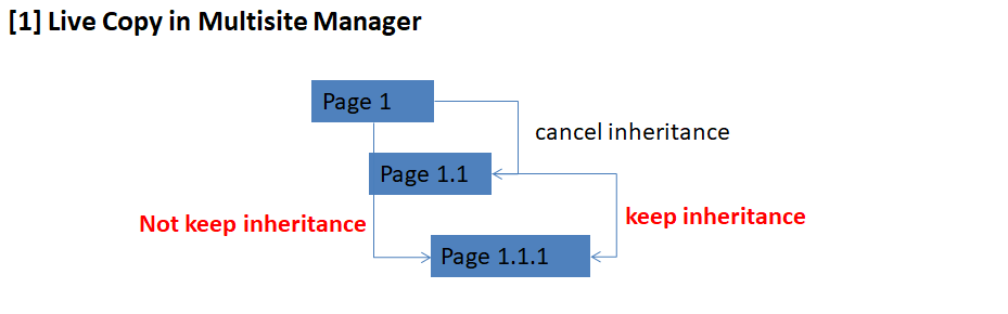

How can I fix it in order to keep the inheritances in Live Copy?
When I cancel  the inheritance between Page 1 and Page 1.1, can the inheritance between Page 1 and Page 1.1.1 and the inheritance between Page 1.1 and Page 1.1.1 still keep at the same time in Live Copy?
If not so, how can I fix it in order to keep the inheritances in Live Copy?
