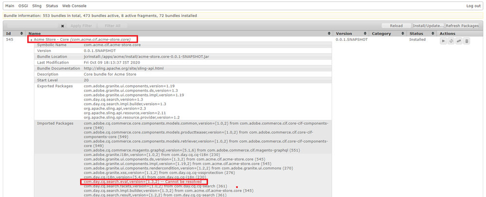

I have created project CIF Archetype Project, Once I build the project. I am able to see below bundles on Console - http://localhost:4502/system/console/bundles
However, their status is Installed not Active, there were some dependencies issue, I fixed all except first Bundle screenshot given below, but other bundles are still not active.

Build error that you have highlighted says "error found in bundle configuration" implies any issue due to the recent changes done on maven-bundle-plugin definition (Should be while adding Export packages list that you have mentioned)
Root cause of bundle not being "Active" seems to be simple which is "packages that we are referring in our bundle is not available/unable to find in the instance". However steps to be taken depend on the package that we are using.

2. List of packages which are in red/not resolved state:
org.apache.sling.api.resource,version=[2.11,3) -- Cannot be resolved
org.apache.sling.api.resource.provider,version=[1.2,2) -- Cannot be resolved
com.adobe.granite.ui.components,version=[1.19,2) -- Cannot be resolved
com.adobe.granite.ui.components.ds,version=[1.3,2) -- Cannot be resolved
com.day.cq.search,version=[1.3,2) -- Cannot be resolved
3. Did you add any dependency in specific. If yes, mention the same - NO
