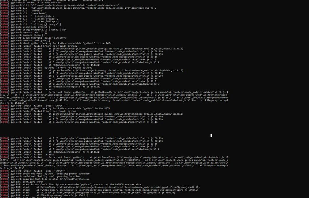

error while installing the maven build AEM project.(mvn clean install)
Hi all,
I build a project using maven archetype 26 and when I tried to run mvn clean install -PautoInstallSinglePackage
It throws me error at npm install (UI frontend).
I thought npm should be upgraded but guess what I didn't even installed node.
I tried in another laptop following same steps, surprisingly I was able to install there (Didn't installed node here too)
So, If there is any particular solution that can solve this issue without installing node please let me know.npm-install-error.JPG

Can you please post the error screenshot above the build status, the previous screenshot does not cover the full error. Or alternatively, please post the npm-debug.log

the debug file was large. the page didn't responding after pasting it.
@rohith_m As visible in the screenshot the node version is fine and matches with the pom, while npm versions are different :
POM has - 6.9.0 &
your cmd shows - 3.10.8
You can check version by opening CMD at path (/ui.frontend/node) and execute : npm -v

I don't know why it showed 3.10.8 there, but I ran the same command and these are the images.npm1.JPGnpm2.JPGnpm3.JPGnpm4.JPG
