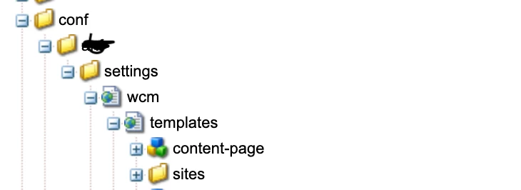

My project had created editable templates with this hierarchy.
/conf/<<projname>>/settings/wcm/templates/sites .
In Template Editors whatever templates created under /wcm/templates can be seen. But in my current project templates are under /wcm/template/sites. So we are unable to seethe templates in Template Editors though we can still see the templates for page creations.
Is there any way to make the templates visible under Template Editors as well ?

Hi @testtttt1 ,
As per documentation, if you need to separate the templates, then you need to achieve using separate folders, for example-
/conf/<folder-01>/<folder-02>/settings/wcm/templates
/conf/<folder-03>/settings/wcm/templates
https://experienceleague.adobe.com/docs/experience-manager-cloud-service/content/implementing/developing/full-stack/components-templates/templates.html?lang=en#template-folders
I believe the OOTB script is written in such a way that the templates are not loading because of the folder hierarchy you have used.

Hi @testtttt1
If you want to see the folders you will probably have to override the OOTB functionality . As per the code it refers to this file under libs
/libs/cq/gui/components/siteadmin/admin/templates/datasources/datasource/datasource.jsp where they are looking for template type before adding to the return resources. Again this will not be a recommended approach .
August 17, 2023
Yes. Your templates should be immediately under /wcm/templates. The subdirectory sites is causing your issue. Move your templates one directory up and you will see them appearing in the Granite UI's Toolbox.
