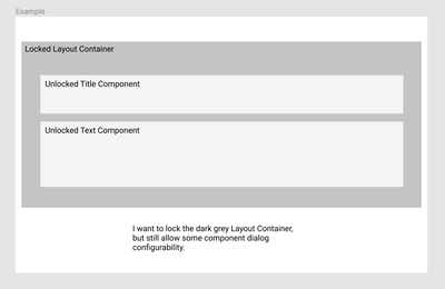

Our marketing team is in a place where we can start to define locked layouts on our editable templates.
We extended the Layout Container to allow authors to set basic positioning like Margin and Padding. This has has been an incredible benefit for our authoring team that previously waited weeks or months for simple padding adjustments to come through dev. The snag is that we want to lock those padding/margin/ect values that are set in the component config dialog. On the other hand, we need to give authors the ability to set other component config dialog attributes like container backgrounds colors or images.
Currently, if an author is to have configurability of a component it needs to be unlocked, but this means you can't place any locked components inside the component. We have already tried using Initial Content, but then we lose the benefit making a template level change to something like padding and having those changes cascade to all pages.
Note: We are already exploring using the Style System. The time necessary to develop and test Style System changes is a problem.
Question 1: Is there any way to make certain locked component attributes authorable on an editable template?
Question 2: Is there any way for Unlocked Containers to house Locked components (for reasons of cascading styling changes)
