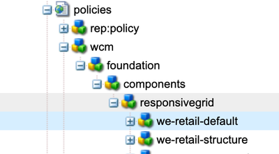

The policy would have to be set for each of the resposivegrid through UI. You can refer to we.retail project to see the policy structure. In the below example, experience-page has 'root' responsivegrid and a responsivegrid inside it and both will have different policies
'root' node has we-retail-structure and 'responsivegrid' node has 'we-retail-default' policy
And these two policies are defined under 'policies' main node
there are two types of policy there, one is for container layout and another is for component.
