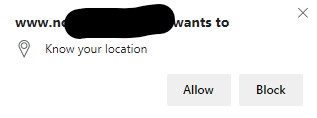

How can I turn of location request for a specify website. We are currently using AEM and Adobe Launch to get analytics data but we don't want our website to ask user for there location.

Depends on which component on your page is asking for this. If you're unsure, try deleting all components on a local system and see if the prompt goes away after a specific component is deleted.
It could also be because of something in your Analytics/Target code. You can find out by removing the cloud service configs from that page to confirm if it goes away. If it is indeed the Analytics/Target integration, then you would need to debug those scripts.
It could be also context hub if you're using it.

Some additional details - https://www.albinsblog.com/2019/04/issue-with-turning-off-location-tracker-remove-geolocation-aem.ht...
