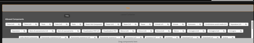

@HybrisAd
I meant the dialog for the teaser component. Can you check if its present? and also check if the resource type path you are using for teaser component is correct.
If both things check out fine, then can you check if Teaser and Title component that you are trying to include, are they allowed in the template policies. If not , allow once and then check.

imageDelegate="mrll/components/image"/>this is the teaser dialog and the recource type is correct; this is the policy and teaser are allowed in the content page
