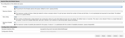

This may be due to the parallel jobs running and not completed, can you change/increase the configuration for parallel jobs, this may give more time for job to complete.
Above image show the config details for the same.
Hope this helps!!!
